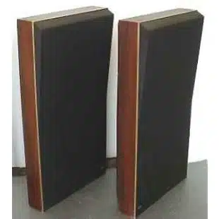

Beovox Uni-Phase P45 loudspeaker was a revised version of the Beovox P50 and was a high fidelity panel speaker for wall-mounting. Weighing only 8kg the P45 had a net volume of 25 litres. Frequency range was 40 – 20 000 Hz with less than 1% harmonic distortion. There were two 12,5cm woofers, a special 8cm […]
Weighing only 8kg the P45 had a net volume of 25 litres. Frequency range was 40 – 20 000 Hz with less than 1% harmonic distortion. There were two 12,5cm woofers, a special 8cm Phase Link unit and a 2,5cm dome tweeter.
Type Number:6307
Release Date:1975, 1976, 1977, 1978, 1979, 1980
Designer:Jacob Jensen
Colour / Finish:Rosewood, White
Continuous load 45 W
Music load 75 W
Impedance: 4 – 8 ohms
Frequency response +4 -8 dB 45 – 20,000 Hz
Sensitivity: 4.2 W
Net volume:15 litre
Gross volume: 25 litre
Woofer: 2 x 12.5cm
Phase link unit: 9 cm
Tweeter: 2.5 cm
Dimensions W x H x D: 35 x 65 x 14cm
Weight: 8 kg
