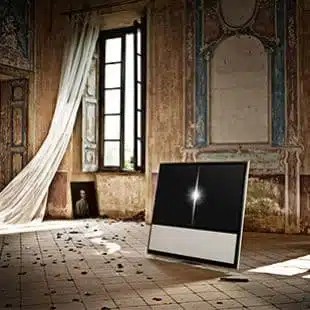

Beovision 11-46
Beovision 11-46
B&O’s first smart TV, being based on the design of the successful Beovision 10. Major changes include the 3D facility and an upgraded sound performance. 6 HDMI ports are available, one being on the accessory panel, and the TV can be controlled with either the Beo4 or 6 or via an iPad or Android tablet.
