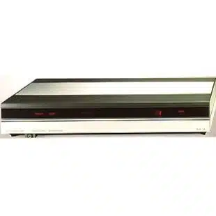

Beomaster 5500 was the brains and heart of the system which it made up. Connected by Datalink to the record player, tape recorder and CD player it allowed the user to remote-control the whole system via the Master Control Panel. The 2 x 60 watt/8 ohm tuner/amplifier gave true hi-fi quality. Bang & Olufsen’s Automatic […]
Connected by Datalink to the record player, tape recorder and CD player it allowed the user to remote-control the whole system via the Master Control Panel. The 2 x 60 watt/8 ohm tuner/amplifier gave true hi-fi quality. Bang & Olufsen’s Automatic Power Handling Control system prevented overloading and distortion, regardless of how many speakers were connected. Up to 20 stations on the tuner could be preset and the frequency synthesizer took care of automatic search and fine tuning of stations. The result – superb reception of LW, MW and FM wavebands and impressive ease of use.
Beomaster 5500 was aesthetically balanced to match the rest of the components within Beosystem 5500
These days, these receivers are the cheapest of the Beolink 1000 controlled stackable systems. They do have the huge advantage of having not only DIN connectors but also a full complement of RCA plugs. This actually makes them ideal for present day use as the extra connections allow computer and digital music connections in addition to usual sources.
