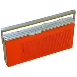

BeoLit 700 (1972)
Beolit 700 Type 1505 was equipped with FM, LW and MW. The radio was compact and light and offered extremely high quality sound. There were sockets for one external speaker and for a record player or tape player/recorder. The portable radio was produced for the European marked and used 220-240V, 50Hz 0,7-5W, or a set of five size-D, 1,5V batteries.
The Beolit was one of the very few portable radios that were suitable for reproducing more than just news broadcasts. Sound quality was so good that music programmes could be reproduced with a quality that made them worth listening to. The Beolit was fitted with a mains transformer and a detachable lead. Operation was simple and problem-free. And since portable radios can end up in unenviable situations, the Beolit was constructed to withstand some rough treatment. A robust chassis protects the internal circuitry and a special surface treatment protects the radio from scratches. Dirty marks were easily removed with a damp cloth.
