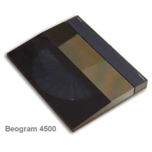

In building the Beogram 4500 turntable, Bang & Olufsen applied all its classic principles to ensure reproduction as close to perfection as possible. The electronically-controlled tangential arm played each record exactly as it was recorded. And there were built-in systems that helped prevent vibrations reaching the cartridge or turntable. Beogram 4500 employed a finer, ultra-lightย MMC2ย cartridge […]
The electronically-controlled tangential arm played each record exactly as it was recorded. And there were built-in systems that helped prevent vibrations reaching the cartridge or turntable. Beogram 4500 employed a finer, ultra-lightย MMC2ย cartridge that combined distinguished sound reproduction with maximum protection for your records.
Beogram 4500 could be used as part of theย Beosystem 4500ย hi-fi system, and – having an inbuilt RIAA pre-amplifier can be plugged straight into the AUX port of your modern B&O equipment and enjoyed with the minimum of fuss!
Type Number:5951, 5955, 5954, 5953
Release Date:1988, 1989, 1990, 1991
Designer:Jacob Jensen
Colour / Finish:Aluminium and Black
Wow and flutter, DIN < +/- 0.06 %
Rumble DIN weighted > 80 dB
Rumble DIN unweighted > 55 dB
Speeds: 33 โ€“ 45 rpm
Speed deviation: < +/- 0.2 %
Power supply:
5951: 220V
5953: 120V
5954: 100V
5955: 240V
Power consumption: < 10 W
Dimensions W x H x D: 42 x 7.5 x 32.5 cm
Weight 5.3 kg
