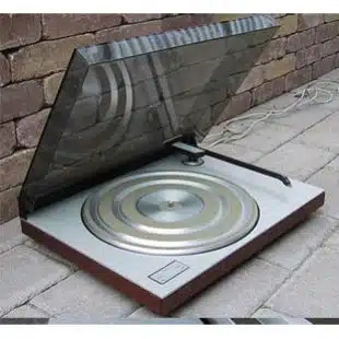

The top of the range of the radial turntables at this time, it was differentiated only by a different pick up and a weighted platter from the lesser models. As with all this range, fully automatic and cleverly designed to look even lower than it actually was!
Type Number:5701, 5702
Release Date:1976, 1977
Designer:Jacob Jensen
Colour / Finish:Rosewood, Teak, White
Cartridge Type:MMC4000
Sound system Stereo, matrix
Speeds: 33 – 45 rpm
Tonearm: radial
Automatic pickup movement: Yes
Automatic speed selection: Yes
Output: 2 x 0.6 mV
Wow and flutter DIN: < +/- 0.07 %
Rumble DIN unweighted: > 42 dB
Rumble DIN weighted: > 62 dB
Speed deviation: < 0.1 %
Speed control range: > 3 %
Dial for speed stroboscope: 120mm
Pick-up cartridge: MMC 4000
Recommended stylus pressure: 1 g
Stylus pressure range: 0 – 2.5 g
Stylus: elliptical naked diamond
Radius of curvature: 5 x 17 µm
Frequency range: 20 – 25,000 Hz +/- 2.5 dB Tracking error < 0.126 / cm°
Lift system Mechanical
Antiskating Inclined channelling inside bearing
Motor Asynchronous
Drive system Idler wheel and belt
Turntable 30cm/1 kg
Power supply: 110 – 220 V
Power consumption: 10 W
Dimensions W x H x D: 44 x 9 x 33cm
Weight 6 kg
