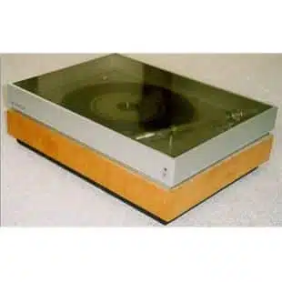

BeoGram 1800 (1968)
This was a rare and interesting model. It boasted a new arm and motor compared to the Beogram 1000 but retained quite a lot of the design and the uninspired rubber mat.
It also had a most unusual dust cover with a metal surround with only the top panel being transparent. This design was to be seen also in the prototype Beogram 6000 but not in any production model.
