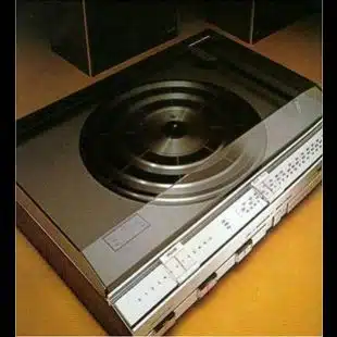

Beocenter 2800 was a unique combination of FM/AM tuner, a 2 x 25 watts RMS hi-fi power amplifier and record player. The tuner section offered Long and Medium wave reception as well as FM. There were facilities for pre-setting the four FM stations you listen to most frequently. Ceramic filters, AFC, split-supply output and a phase-locked loop decoder were some of the features that ensured outstanding reception and reproduction of even distant stations.
The record player was fully automatic – one master switch controlled all operations. The anti-skating device was built into the arms suspension and worked automatically. Electronic Servo Drive (ESD) ensured constantly correct speed. There were sockets for tape deck, two sets of stereo speakers and headphones.
This was a compact, space-saving unit which was easy to use thanks to automatic circuits and logical controls. Beocenter 2800 could be made up as part of the Beosystem 2800, when linked together with other compatible Bang & Olufsen products
