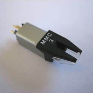

This cartridge was in many ways the replacement for the MMC20EN as it had a tapered cantilever and naked elliptical stylus. It was fitted as standard to the Beogram 6002.
Release Date:1984, 1985, 1986, 1987, 1988, 1989, 1990, 1991, 1992, 1993, 1994, 1995, 1996
Colour / Finish:Black, Silver
Description Nude elliptical diamond mounted on a tapered aluminium cantilever Tracking force – grams 1.2
Diamond Stylus Elliptical nude
Cantilever tube Tap. alum. .
Effective tip mass mg 0,35
Compliance mg/mN 25
Frequency 20-20000 Hz=/-dB 2
Channel separation 1000>dB 25
Output mV/cm/s RMS 0,6
Cartridge weight gram 1,6
