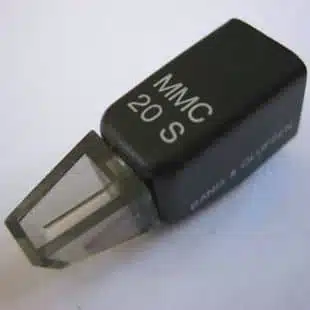

MMC20S
Prior to the release of MMC1 – 5 cartridges, Bang & Olufsen had the following MMC range of combined styli and cartridges:
MMC cartridges were available with standard ½” mounting brackets, or with easy plug-in, lightweight connectors. These enabled you to mount MMC cartridges onto non-Bang & Olufsen arms. The cartridges plugged directly into Beogram pickup arms without additional mounting gear
MMC 20 S was a stereo cartridge with a spherical framed diamond
