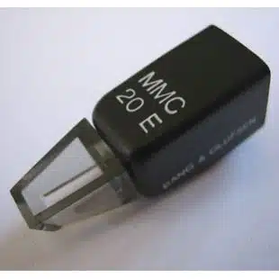

Prior to the release of MMC1 – 5 cartridges, Bang & Olufsen had the following MMC range of combined styli and cartridges: MMC cartridges were available with standard ½” mounting brackets, or with easy plug-in, lightweight connectors. These enabled you to mount MMC cartridges onto non-Bang & Olufsen arms. The cartridges plugged directly into Beogram […]
MMC cartridges were available with standard ½” mounting brackets, or with easy plug-in, lightweight connectors. These enabled you to mount MMC cartridges onto non-Bang & Olufsen arms. The cartridges plugged directly into Beogram pickup arms without additional mounting gear
MMC 20 S was a stereo cartridge with a spherical framed diamond
MMC 20 E was fitted with a framed elliptical diamond which has a high polish
MMC 20EN had a naked elliptical diamond, mounted on a tiny tapered cantilever
MMC 20 CL utilised a Contact Line naked diamond mounted on a single crystal sapphire cantilever. This shape ensures maximum groove contact. This was the most highly-specified cartridge in the MMC 20 range
