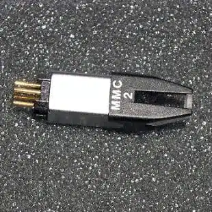

The MMC2 was the replacement in the B&O line up for the very successful MMC20CL. Like the MMC1, it boasted a sapphire tubular cantilever and line contact diamond. It was fitted as standard to the top of the range Beograms such as the 8002 and the 7000.
Release Date:1985, 1986, 1987, 1988, 1989, 1990, 1991, 1992, 1993, 1994, 1995, 1996
Designer:Jacob Jensen
Colour / Finish:Silver and black
Nude multi-radial Contact Line diamond, mounted on a sapphire cantilever
Tracking force – grams 1
Diamond Stylus Cont. line nude
Cantilever tube Sapphire
Effective tip mass mg 0,3
Compliance mg/mN 30
Frequency 20-20000 Hz=/-dB 1,5
Channel separation 1000>dB 25
Output mV/cm/s RMS 0,6
Cartridge weight gram 1,6
