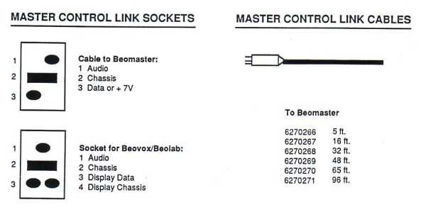

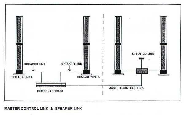

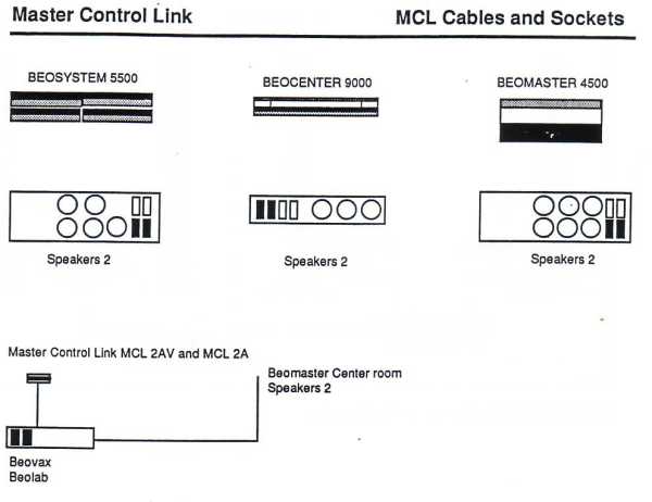

The Master Control Link connection at the Speaker 2 output sockets of a BeoMaster/BeoCenter. Connection from this point is made to the MCL ABLI or MCL2AV relay box via a special 7-conductor cable with 3-pin speaker plugs on one end and bare wires on the other.
The MCL cable carries speaker level signals, left and right. Along with the speaker signals, a two-way data signal is carried for communication purposes between main room and local room, as well as display data for BeoLab Penta or BeoVox panel speakers. The BeoMaster/BeoCenter also supplies 7 volts DC which is transferred via the link cable to the relay box. This power source is used only by the MCL 2ABLI. The MCL 2AV receives its power either from a separate power supply or from the MCL 2P amplifier.

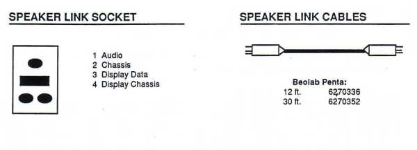

Speaker Link defines the connections between a BeoMaster/BeoCenter Speaker 1 output and a pair of active or passive speakers in the main room.
Audio signals are transferred at speaker level. The top pin of the socket is the speaker ‘hot’, the blade the speaker ground. The bottom pins are used to transfer data and data ground from the BeoMaster/BeoCenter to BeoLab active speakers.
Connection to BeoLab speakers via speaker link must be done with shielded speaker cables.

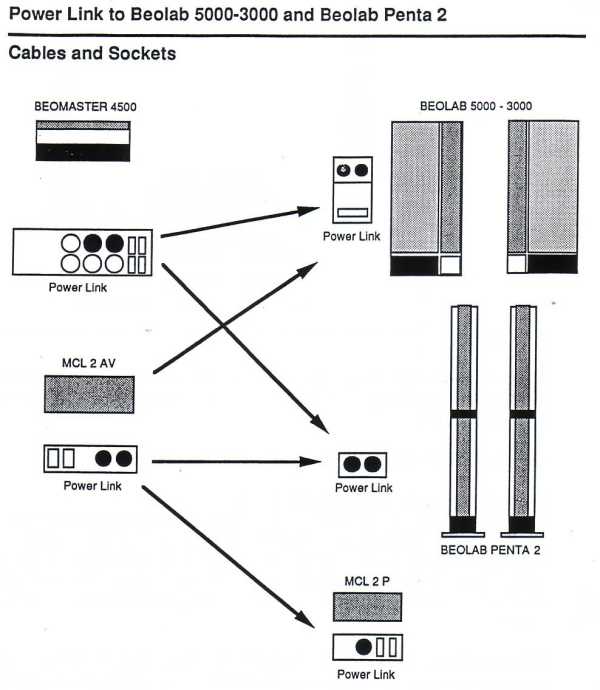

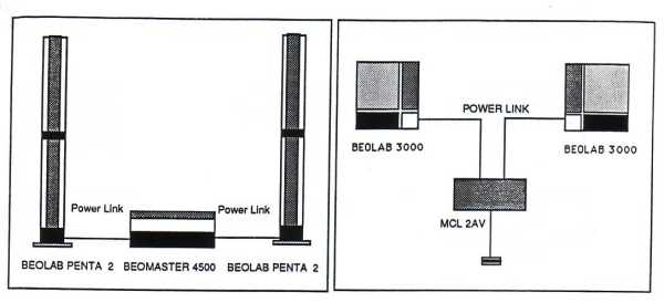

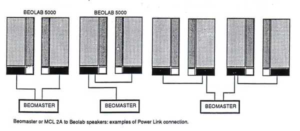

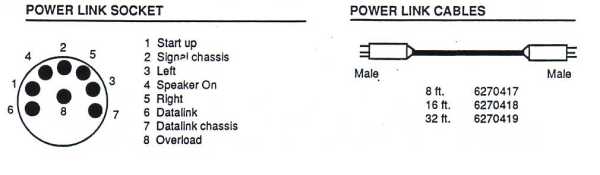

PowerLink defines the connection between a BeoSystem or MCL2AV with 8-pin DIN PowerLink sockets and BeoLab active speakers or the MCL2P power amplifier.
The PowerLink connection carries both left and right pre-amp output signals. Additionally, the PowerLink connection transfers data signals for the BeoLab active speaker (and status display for those active speakers fitted with this LED readout). The remaining connections provide turn on and protection signals (APHC) for the amplifier.
PowerLink outputs may be adapted to standard RCA outputs for driving non-B&O power amplifiers using a DIN to RCA adaptor number 6270316.
The remote mains switch may be activated by the PowerLink outputs using DIN to DC female adaptor number 9627100.
Note that there are two thicknesses of PowerLink cable: the thick cable should be used for source display on active speakers with such displays (like BeoLab Penta, BeoLab 4500, BeoLab 5000); the thinner cable is unable to do this.

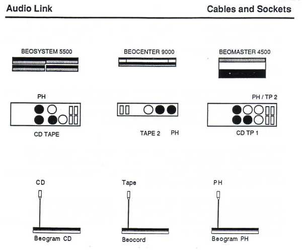

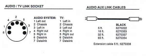

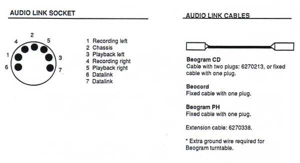

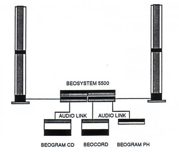

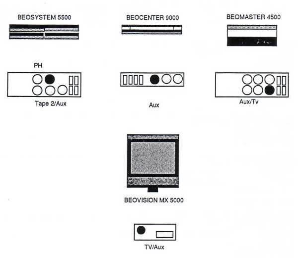

Audio link connections are those which take place between an audio master (like BeoMaster or BeoCenter) and its program sources: BeoCord, BeoGram record deck and BeoGram CD.
Both analogue stereo signals and two-way Datalink codes for operation and display are transferred. For BeoGram turntables and CD players the analogue signals are one-way, from the source to the Master. These signals terminate at pin 3 (left) and pin 5 (right) of a 7-pin DIN plug. Pin 2 is the signal ground. BeoGram 5500 and 9000 transfer signals at phono level. All other products transfer signal at line level.
In addition to the above, audio signals are transferred to the BeoCord from the audio master for the purposes of recording. These signals take place at pin 1 (left) and pin 4 (right) of the 7-pin DIN plug. All signals are at line level.
BeoCord signal cables may be extended via extension cable number 6270338.

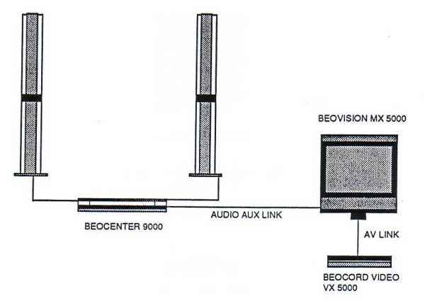

Audio Aux Link is the connection between a Bang & Olufsen MX 5000 television and a Bang & Olufsen Beolink compatible audio system. This connection is also known as a Beolink connection.
Both analogue stereo sound signals and two way Datalink codes for operation and display are transferred. Audio signals are in two directions. This gives the ability to play audio signals from the video system through the audio system, as well as allowing programs from the audio system to be played through the MX 5000 TV set.
The Audio Aux Link connection also permits sound from the VX5000 VCR to be played through the audio system and sound from the audio system to be recorded on the VX5000. This connection takes place automatically whenever a VX5000 is connected to an MX 5000.
In practice, the Audio Aux Link connection is identical to the Audio Link connection for BeoCord audio. Therefore, the same types of cables and extensions which are used for two way Audio Link connections may be used for Audio Aux Link connections.

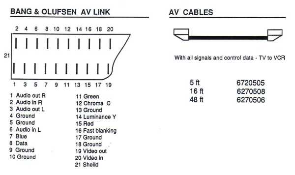

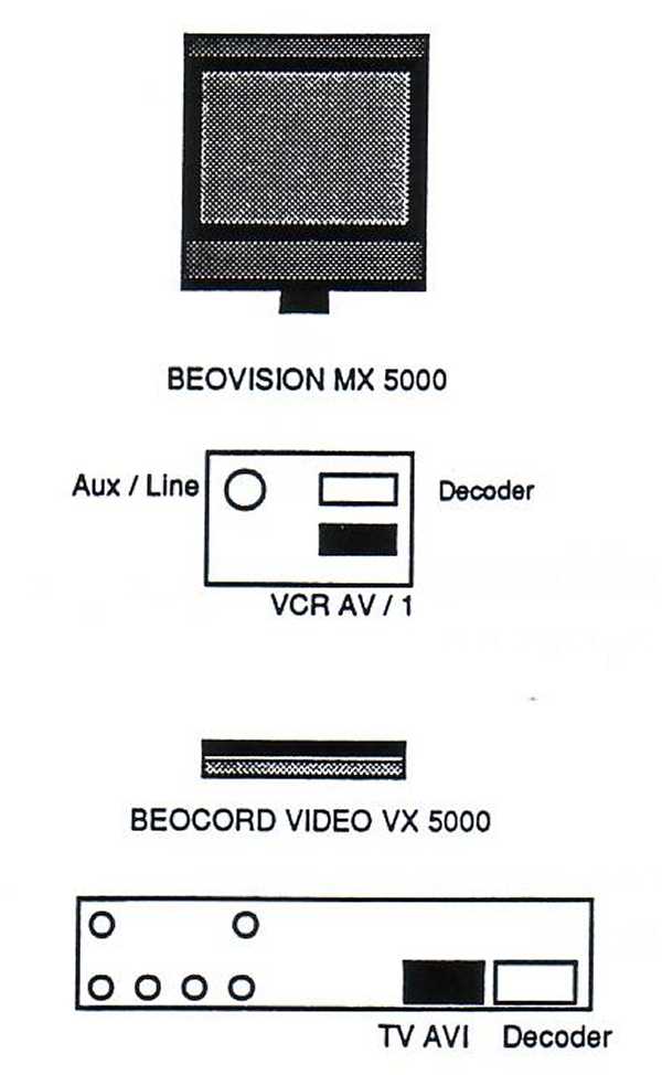

AV link describes the connections between the MX5000 TV and the VX5000 VCR.
The AV link transfers audio, video and data signals between the MX5000 TV and VX5000 VCR. A special cable with 21 pin SCART plug on each end is used to accomplish the AV link connection.
Audio signals are transferred in both directions between TV and VCR. This allows sound recording from the audio system via the Aux Link connection to the TV set, as well as playback of stereo sound from the VCR through the TV or the audio system.
Composite video signals are transferred from the TV to the VCR. This allows recording from a second VCR, camcorder or other video source.
