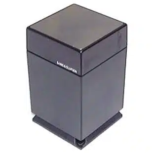

LC1 Light control module (1989-1992)
With the LC1 light control unit it became possible to regulate lighting levels and distribution using a Beolink 1000 terminal. The Mk3a Beolink 1000 was the first terminal to include a ‘Light’ key, and this, in conjunction with the volume keys, set the light level. Up to nine LC1 light controls could be used in one room, using the number keys on the Beolink 1000. LC1 light controls could also be preset at a number of different intensities, so that different ‘light pictures’ could be called up quickly and easily. The LC1 also had a sensi-touch area on its top surface in order that the connected light could be switched on and off manually.
