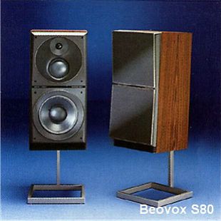

Beovox S80
Beovox S80
There was a 7,5cm mid-range/phase-link unit combined with a 20,5cm woofer and 2,5cm dome tweeter to provide a wide frequency response and no audible phase distortion. Overload protection was automatic. The cabinet was of pressure chamber construction. Optional pedestals and wall-fixing kits were available.
Type Number:6414
Release Date:1981, 1982
Designer:Jacob Jensen
Colour / Finish:Oak, Rosewood, Teak, White
RMS power handling capacity 80 W
Music power handling capacity 110 W
Impedance: 8 ohms
Frequency response 4+ -8 dB 50 – 22,000 Hz
Frequency response +/- 4 dB 70 – 20,000 Hz
Sensitivity: 4 watts
Distortion 250 – 1000 Hz
1000 Hz <0.7%
Woofer: 21 cm, throw +/- 3 mm
Phase-link, mid-range: 7.5 cm dome
Tweeter: 2.5 cm dome
Net volume: 24 litre
Gross volume: 37 litre
Dimensions W x H x D: 26.5 x 53 x 27.5 cm
Weight 9 kg
