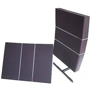

The speakers accentuated different sound facets when positioned in different ways. Special fittings allowed you to position the three largest RL speakers as you wished. Suspended from the ceiling or on the wall. Standing in a corner or on a shelf. Or placed discreetly on the floor – either on a stand or in direct contact with the floor if you really wanted heavy bass sound – for dancing for example. The hard moulded plastic shell had no parallel surfaces, and the space between the bracing ribs was covered with asphalt. This special construction ensured a pure and authentic sound experience – with minimal cabinet resonance.
The special fittings, available as accessories, made it possible to tilt and turn Beovox RL speakers, in order to focus the sound towards your listening position, giving you the perfect stereo perspective.
