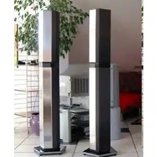

Smaller, but perfectly formed For rooms where you didn’t need so much power, Beovox Penta was the little brother which suited you down to the ground. It didn’t have the built-in amplifier or the light display, but it was identical to BeoLab in all other respects.
Type Number:6611
Release Date:1986, 1987, 1988, 1989, 1990, 1991, 1992
Colour / Finish:Silver
RMS power handling capacity 150 watts
Music power handling capacity 200 watts
Impedance 8 ohms
Frequency range 4+ -8 dB 40 – 20,000 Hz
Power at 96 dB SPL 2.5 watts
Sensitivity 1 W 92 dB
Distortion 250 – 1000 Hz
1000 Hz <0.5%
Cabinet principle: Bass reflex
Woofer: 4 units 13 cm
Mid-range: 4 units 8 cm
Tweeter: 2.5 cm
Net volume: 32 litre
