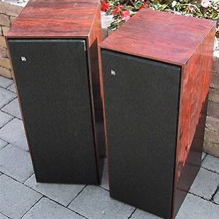

Rated at 30W, the Beovox 2600 was powerful enough to be used with the Beomaster 3000, though it was also recomended for use with the Beomaster 1000, 1200 and 1600.
Slightly larger than the Beovox 1200 of the same year, it was fitted with an 8” woofer with a rubber roll edge and a 1.5” dome tweeter. Befitting a loudspeaker to be used with the excellent Beomaster 3000, the Beovox 2600 met all the conditions of the DIN 45 500 “hi-fi” standard.
BeoVox 2600 Product Details
Type Numbers
Please let us know​
Designer
Please let us know
Manufactured
1969 - 1972
Colour Options
Rosewood, Teak
BeoVox 2600 Product Specification
Dimensions W x H x D 60 x 24 x 27,5cm
Weight 10 kg
Performance
Music load 40 watts
Continuous load 25 watts RMS (DIN 45,573)
Frequency response 35 – 20,000 Hz (DIN 45,570)
Distortion Max. 2% (DIN 45,403)
Sensitivity 4 watts (DIN 45,500)
Crossover frequency 2 kHz/10 kHz
Capacity 25 litres
Resonance of woofer 30 Hz
Dispersion 120 °
Number of units
Bass unit: 1 x 20cm
Mid-range One DOME unit
Tweeter: 1 x 5cm
Connections: Input DIN socket – 4 ohms
