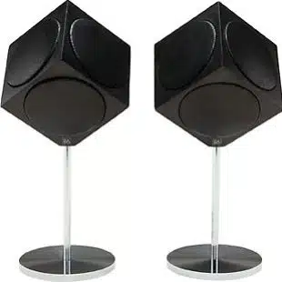

The problem back then was the same as today; whereas there is no directional problem with the bass, how to ensure dispersion of the midrange and treble? The focus was on the treble, as the higher the frequency range, the narrower the field of dispersion. Beovox 2500 Cube, released in 1967, was an attempt at an omni-directional treble loudspeaker, where the six driver units in the cube-shaped cabinet overlapped to cover all fields. The six driver units, one on each face of the cube, presented a rather special placement problem, which was solved by balancing the loudspeaker on one of the corners. It could therefore rest on a stand or hang from the ceiling.
Of course, with the overlapping fields and reflections from walls, floor and ceiling, the solution wasn’t perfect, but the Beovox 2500 Cube received universal acclaim from audiophile circles at the time for its ability to provide omnipresent sound. Its compact proportions and design, as well as the idea behind it have all contributed Beovox 2500 Cube’s current status as a cult product.
With its six high-frequency tweeters radiating in all directions, Beovox 2500 could be base- or wall-mounted, or even mounted from the ceiling. The compact speakers ensured complete spatial distribution of the highest notes, and its maximum power handling capacity in the range above 2000 Hz was 60W. The speaker was the ideal tweeter for a Beolab system. It could be connected to Beovox 5000 and Beovox 3000.

Dimensions W x H x D 95 x 95 x 95mm
(Height with stand: 285mm)
Weight 1,6kg
Power handling capacity 50 Watt peak
Frequency response (DIN 45570) 2000 -18000 Hz
Impedance 4 ohms
Angle of coverage 360°
