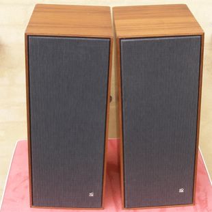

BeoVox 1200 Product Specification
Dimensions W x H x D 50 x 20 x 24 cm
Weight 5,5 kg
Performance
Music load 20 watts
Continuous load 15 watts (DIN 45,573)
Frequency response 40 – 20,000 Hz (DIN 45,570)
Distortion Max. 3 % (DIN 45,403)
Sensitivity 4 watts (DIN 45,500)
Crossover frequency 4000 Hz
Capacity 17 litres
Resonance of woofer 35 Hz
Dispersion 90°
Number of units
Bass unit One 6 in.
Tweeter One 2 in.
Connections: Input DIN socket – 4 ohms Dimensions W x H x D 50 x 20 x 24 cm
Weight 5,5 kg
Type 6235
Performance
Music load 20 watts
Continuous load 15 watts RMS (DIN 45,573)
Distortion Max. 2,5 % (DIN 45,403)
Crossover frequency 3 kHz / 10 kHz
Capacity 17 litres
Dispersion 120 °
Number of units
Bass unit One 7 in.
Mid-range One DOME unit
Tweeter One 2 in.
