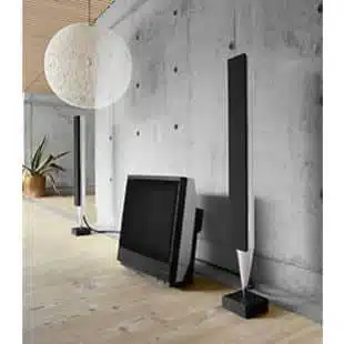

BeoVision MX makes TV a discreet part of your interior decoration. Uncompromising sound and picture quality come as standard. With the BeoVision MX range, television becomes a versatile feature that blends into your home and lifestyle.
BeoVision MX TVs fit where they’re wanted. BeoVision MX 8000 is ideally suited for standing alone or being used on a motorised stand.

There are three placement options – a stand (with optional shelf for DVD 1 or Beocord V8000 – as in above picture), a motorised floor stand and a motorised base. It also has its own in-built stand to tilt back the set (as in BeoVision MX4000/4002).
