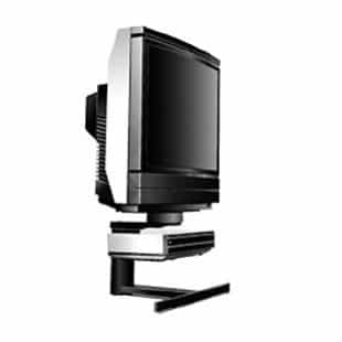

The MX range was the first to bring the TV out into the open and it continues to show alternative ways of living with television. Beovision MX7000 was Bang & Olufsen’s first television set designed with active speakers. Beovision MX 7000 comes with the same Active loudspeakers technology that’s found in the BeoLab range of […]
Beovision MX 7000 comes with the same Active loudspeakers technology that’s found in the BeoLab range of loudspeakers. By building the amplifiers directly into the speaker cabinet we’re able to ensure a sound performance that’s second to none. With the MX 7000 you have a full range of 6 colours and 5 placement options. Whether you prefer blue to red or a motorised stand to a non-motorised stand, the MX 7000 will give you a number of possibilities: 66cm screen with VisionClear, active loudspeakers, improved Teletext, Beo4 remote control, connections for Beolink®, VCR and headphones, optional module for satellite, BeoStands and motorised stands and available in pearlescent shades of: blue, green, red, grey, black or glossy white.
The Beovision MX series has become a classic. Designed by the famous David Lewis in the ’80s, this television set has gradually developed through the years to become the most known TV in the world today. Much has happened, however, since the first version. Today the MX7000 is equipped with the latest in picture and sound technology. This is the first, and probably only, TV with an built-in active speaker system. By using the same technology as used in all their stand alone active speakers, Bang & Olufsen have managed to provide sound quality that is hard to believe. The MX6000 is really the same machine as the MX7000 but without the active speakers. It features a passive system instead. When it comes to the picture, the current version features a 28 inch Backline S CRT along with the contrast screen and the other VisionClear components.
The MX series can, of course, be equipped with built in satellite receiver/Positioner and a Picture-In-Picture (PIP) module. For those wishing to use the Teletext subtitles when a program is using them the MX sets automatically turns them on and, in conjunction with a Beocord VX7000, it can also record a program with subtitles. All versions can be connected to the motor stands giving the possibility to adjust the viewing angle remotely. The MX7000 is available in the same colours as the Avant, namely pearly red, blue, black, green and grey.
With the MX range, the TV finally becomes a discreet part of your interior decoration. Choose between a 51cm or 66cm screen, 6 different colours and a versatile range of stands and brackets – with or without motorised turning. What comes as standard, however, is an uncompromising sound and picture quality that has set the reference for modern television.
