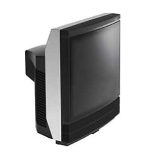

Beovision MX6000 delivers the same uncompromising picture quality as the MX 7000. The only difference is the loudspeaker system which has conventional amplification using built-in passive speakers. The MX television range was the first to bring the TV out into the open and it continues to show alternative ways of living with television. With the […]
The MX television range was the first to bring the TV out into the open and it continues to show alternative ways of living with television. With the current MX range, the TV finally becomes a discreet part of your interior decoration. Choose between a 51cm or 66cm screen, 6 different colours and a versatile range of stands and brackets – with or without motorised turning. What comes as standard however, is an uncompromising sound and picture quality that has set the reference for modern television.
The Beovision MX series has become a classic. Designed by David Lewis in the 1980s, this television set has gradually developed through the years to become the most well-known TV in the world today. Much has happened however, since the first version. Today the Beovision MX6000 is equipped with the latest in picture and sound technology. This is the first, and probably only, TV with an built-in active speaker system. By using the same technology as used in all their stand alone active speakers, Bang & Olufsen have managed to provide sound quality that is hard to believe. The MX6000 is really the same machine as the MX7000 but without the active speakers. It features a passive system instead.
When it comes to the picture, the current version features a 28 inch BlackLine S CRT along with the contrast screen and the other VisionClear components. The MX series can, of course, be equipped with built in satellite receiver/Positioner and a Picture-In-Picture (PIP) module. For those wishing to use the Teletext subtitles when a programme is using them the MX sets automatically turns them on and, in conjunction with a Beocord VX7000, it can also record a TV programme with subtitles. All versions can be connected to the motor stands giving the possibility to adjust the viewing angle remotely.
With two colours and five placement options to choose from, the MX 6000 will suit almost any purpose and room environment. The Beovision MX6000 is basically an MX7000, but with a conventional speaker system instead of active loudspeakers.
