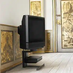

The last word in a fine story, the MX4200 looked modern at its introduction despite being modelled on an 18 year old design. A testament to the vision of David Lewis. Beovision MX4200 is a 52cm 4:3 television set, and is based on an updated chassis of Beovision MX4000/4002. It has the same design line […]
Beovision MX4200 is a 52cm 4:3 television set, and is based on an updated chassis of Beovision MX4000/4002. It has the same design line as the previous MX model range but includes the following improvements:
Improved picture quality
16:9 format handling
Set-Top Box Controller as standard
Camcorder connection
Theft protection
MasterLink module (optional)
RF Modulator (optional)
