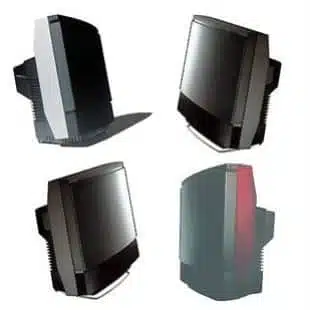

The MX range was the first to bring the TV out into the open and it continues to show alternative ways of living with television. Beovision MX4000 was the little brother of the MX6000 having the same functions but with some minor differences when it came to sound and picture. The speaker was not a […]
The MX range was the first to bring the TV out into the open and it continues to show alternative ways of living with television. Beovision MX4000 was the little brother of the MX6000 having the same functions but with some minor differences when it came to sound and picture. The speaker was not a 2-way bass reflex as in the MX6000 but a 2-way Logline speaker.
Complete with a choice of colours, the specially-designed wall brackets of the MX4000/4002 gave you the option of placing the MX on the wall. The placement options of the MX 4000/4002 also included a motorised stand with room for your VCR/DVD player.
The TV had a 51cm screen, the same features as MX6000, but with conventional loudspeakers, optional wall bracket, available in pearlescent shades of: green, blue, red, grey, black or glossy white. With a Beovision MX 4002 as an extra TV in the bedroom, you could access the video and satellite options of the Avant in the living room or wake up to music from the radio and CD of the Ouverture or BeoSound 3000. Beovision MX4002 was replaced with the MX4200 in 2003.
MX Design
Filling a television with every conceivable gadget that technology offers is easy enough. What’s more difficult is identifying what really improves the overall experience of watching TV and eliminating the things that don’t. That’s the philosophy behind the MX range. In both form and function, it’s a clear-cut case of less being more.
Complete with a choice of 6 colours that included green and white, the specially-designed wall brackets of the MX 4000 gave you the option of placing your MX on the wall. The placement options of the MX 4000 also included a motorised stand with room for your VCR/DVD player. The TV was controlled by the provided Beo4 remote control.
Beolink® – Beovision MX 4002
Beovision MX 4002 was the Beolink® variation of the MX 4000. This model gave you numerous options when you were setting up your Beolink® system and needed an extra television in your bedroom, study or kitchen. The MX 4002 was available in the same colours as MX 4000 and had the same placement possibilities as well.
