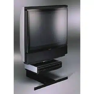

Beovision MS6000 was basically an MX 6000, but the bass reflex loudspeakers were replaced by full tone units and it had no connections for Beolink® and A/V integration. It did however, have stereo loudspeakers and its equipment was otherwise similar to the MX 6000. It was controlled by the remote control Beolink 1000 handset and was available in a […]
Beovision MS6000 was basically an MX 6000, but the bass reflex loudspeakers were replaced by full tone units and it had no connections for Beolink® and A/V integration. It did however, have stereo loudspeakers and its equipment was otherwise similar to the MX 6000. It was controlled by the remote control Beolink 1000 handset and was available in a dark grey finish. Later editions featured the MS6000 in a silver-grey finish. Teletext was included, together with the option of Beo4 control.
The TV was an upgrade from Beovision ME6000 in 1996 and was a TV featuring all the fundamental Bang & Olufsen qualities, at the same time representing “simplification, innovation and common sense”. With the slightly tinted contrast screen and the VisionClear system with Automatic Picture Control, it offered excellent, sharp pictures under all lighting conditions.
The MS6000 could be placed on an optional motorised BeoStand and could be fitted with an optional BeoSat LM receiver.
