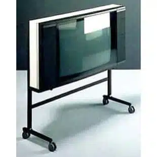

With its 63cm screen, Beovision LX2500 was the smallest member of the LX family in 1987. But no sacrifices were made in sound and picture excellence, nor was Beovision LX2500 ever caught out by new technical developments. No Master Control Link or additional speakers were required when installing a Beovision LX say, in the bedroom. […]
With its 63cm screen, Beovision LX2500 was the smallest member of the LX family in 1987. But no sacrifices were made in sound and picture excellence, nor was Beovision LX2500 ever caught out by new technical developments. No Master Control Link or additional speakers were required when installing a Beovision LX say, in the bedroom. The set came fully-equipped with a Master Control Link and all sound from the central music system could be fed through the TV speakers
