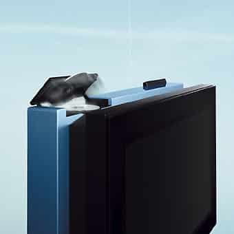

BeoVision Avant 32 DVD
At the end of 2001 several variations of the BeoVision Avant were on offer – the BeoVision Avant 28 with and without VCR, and BeoVision Avant 32 with VCR or DVD player built in as standard. Then from March 2002, the BeoVision Avant 28 DVD was introduced to join its larger-screened brother.
BeoVision Avant encourages you to lose yourself in a sound and picture experience – and not in the technology. That’s why Bang & Olufsen hang the 16:9 Real Flat wide-screen on its own smooth wall and conceal everything else behind it – including a set of speakers that will outpace the average hi-fi and a video recorder that tunes itself automatically.
You could choose a built-in DVD player or video tape recorder and from a range of five colours. There was also the option of a simplified 66cm version – the BeoVision Avant CTV – with no integrated entertainment source.
