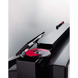

Watching movies should be about simple entertainment, not complicated technology. That’s why the Avant is available with its own built-in DVD or video recorder. Its presence is only given away by a discreet lid on the front. All cables are hidden in the back of the set.

A discreet display on the upper right hand corner of the Avant lets you know what source is playing and a small control panel placed behind it offers hands-on control of all basic functions.
