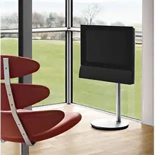

BeoVision 6 – 22 may be fitted with a motorised base which turns the set and also regulates the inclination. Standing possibilities include a low floor stand similar to BeoVision 5, wall bracket or a high floor stand high (as with BeoVision 1).

Mounting Options & Stands
The tilt table mount was available for counter top mounting, designed to allow the bass port on the underside of the TV to ‘breath’. Motorised floor and table stands were complimented by a wall mount bracket which gave manual tilt and turn
