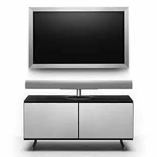

BeoVision 4 offers greater flexibility and modular convenience to Bang & Olufsen customers than has previously been possible. BeoVision 4 is available in different sizes and consists of the screen, BeoSystem 2 and a cabinet. BeoSystem 2 is the master unit having the same functionality as BeoVision 5.
The recommended centre channel loudspeakers are BeoLab 4000. This plasma TV set has been previously only available in the North American market including Canada, Mexico and the US. When combined with speakers and stands, BeoVision 4 becomes an integral part of BeoSystem 1. However, from Spring 2004 the system – known as Beosystem 2 – arrived in Europe.
This European system incorporates different-sized screens and may be mounted on a wall. Available in 50″ and 65″ screen sizes (37″ and 42″ screen sizes available only to March 2006) The screen surround is of brushed aluminium and is based upon much the same design as BeoVision 5. VisionClear and an anti-reflection coating is included. Controlled by Beo4, the system comprises:

Cabinet 2168 is similar to cabinet type 2164 and has a shiny, aluminium-coloured front. Within it can be placed a satellite decoder, DVD 1 and/or Beocord V8000, if these are your required options.

In view of the general expansion of flat screens in the market, Bang & Olufsen is now strengthening its flat screen portfolio by launching BeoVision 4 – 42. BeoVision 4 – 42 is a modular flat screen home-cinema system master consisting of:
A 107cm plasma monitor for wall mounting (wall bracket included)
BeoSystem 2 – a master unit offering the customer a genuine Bang & Olufsen system master
an elegantly designed cabinet for placement of BeoSystem 2 and a separate box solution, e.g. DVD 1.
