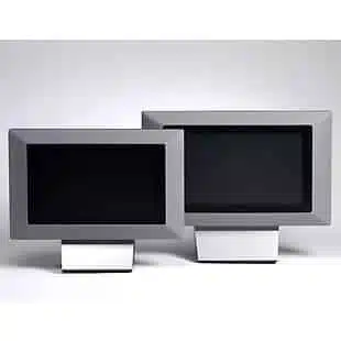

” Close your eyes and imagine your perfect TV. Should it have the latest digital surround sound decoder and a connection for extra loudspeakers? Integrated control of your satellite and DVD sources? And what about an anti-reflection contrast screen to improve your viewing comfort? Whatever you opt for, what you get as standard is Bang & Olufsen sound and picture quality – and a luxurious television experience that matches your own personal needs exactly.
BeoVision 3 28 is a smaller version of the 77cm-screen . The TV set incorporates similar functions to that of its bigger brother but is just a 67cm viewable screen and is designed to allow for greater flexibility in respect of positioning.
This smaller-screened television is, design-wise, the same as BeoVision 3 32. The chassis (50Hz) is basically the same as in BeoVision 1 Update III (50Hz); operation and specification is therefore the same (including the tuner and speakers).
Design
When it comes to widescreen television, you may think that you’ve seen it all before. But take a look at the new BeoVision 3 28 and see what happens when intelligent design meets state-of the art technology. A perfect picture and truly great sound removes the distance between you and what’s happening on the screen.
Picture it for yourself: a wide screen elegantly framed in a colour of your choice. BeoVision 3 is designed to match your personal environment as well as your demands for a perfect viewing experience.
Clear Vision
What is it you’re watching on the screen? A true picture or poor image? The real-flat screen of BeoVision 3 offers the best viewing possible and the widescreen format ensures that it’s made for movie watching.
The more you can lose yourself in a film, the more enjoyable the experience becomes. That’s why anything that comes between the viewer and the picture is eliminated. Like reflections. A special contrast screen coating on the screen – fitted as standard * – reduces them to an absolute minimum and ensures a perfect viewing experience.
VisionClear is not something you’re meant to notice, but just enjoy. It starts already when you switch your BeoVision 3 on. Within a second it adjusts contrast levels, brilliance and colour to match the unique light conditions in the room – and will carry on doing so until you switch off again. (More on VisionClear)
