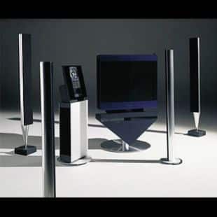

Bang & Olufsen’s Beosystem AV 9000 was a complete home theatre system introduced in 1992 and was designed by the company’s chief designer, David Lewis. The superlative system – in production for seven years – comprised a Beovision AV9000 TV set, a pair of BeoLab 8000 speakers, a pair of BeoLab 6000 speakers, and a […]
Bang & Olufsen’s Beosystem AV 9000 was a complete home theatre system introduced in 1992 and was designed by the company’s chief designer, David Lewis. The superlative system – in production for seven years – comprised a Beovision AV9000 TV set, a pair of BeoLab 8000 speakers, a pair of BeoLab 6000 speakers, and a Master Control Panel AV9000, similar to a BeoSound Ouverture. In addition, Beovision AV9000 contained not just the television, but also a Dolby Surround Sound processor, a modified Beocord VX7000 and an active centre speaker.
Beosystem AV 9000 was, in the early 1990’s the most advanced combination of sound and vision from Bang & Olufsen and was the B&O approach to complete home entertainment. The TV, video and music system used the same set of loudspeakers, so the sound always comes as close to reality as possible. AV 9000 gave you the freedom to choose one of five different sound-settings for every audio/video source – ranging from Dolby Surround Sound to monologue newsflash. Surround Sound was built into the AV 9000 monitor-unit, while the CD, radio and cassette was handled by BeoSound Ouverture, all seamlessly connected to each other. The whole system was surrounded by two set of loudspeakers: tall, slender BeoLab 8000 in front and BeoLab 6000 at the rear. A fifth source was the central loudspeaker in the triangular bottom-half of the television set. The whole system was controlled by one remote control, the Beo4.

Perhaps the first thing that the viewer noticed upon looking at the set, was that there appeared to be no screen! Just like in the cinema, the screen was only revealed when the mechanical curtains parted. When the TV was turned on, a black, completely light-resistant curtain glided to the left and right to reveal the picture, creating further the illusion of a small cinema screen. At the same time the monitor turned toward you to its pre-set position. The picture was incredibly sharp, with deep and clear colours.
Beosystem AV 9000 was more than a music system and more than a video system. It was an integrated approach to home entertainment, which fitted unobtrusively into any living room. The polished aluminium surfaces of the active BeoLab 8000 and BeoLab 6000 speakers took on the colours of their surroundings, while the black cloth covers blended in with outmost grace. In regard to sonic qualities, the loudspeakers are still second to none.
