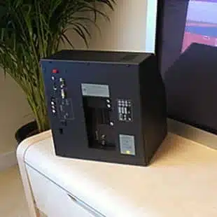

BeoSystem 2
This was the Audio Visual processor designed for use with the Beovision 4. It contained all the connections necessary to make it the hub of an integrated Beolink system.
BeoSystem 2 Product Details
