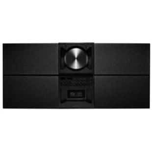

If you want superior sound, but not the size, and a full array of functions but without the complication – then take a look at the BeoSound Century. Designed by David Lewis, it has a very slim depth and brings together CD, tape and FM radio into a slim-line form that can stand by itself or hang from a wall. Everything is operated by buttons that light up to guide you quickly through the various playing options.
BeoSound Century is a clever combination of excellent performance and ease-of-use. This system is known in fact by two different names – BeoSound Century in Europe and BeoSound 2000 in North America. With everything built in, this is the perfect stereo for those who with a limited space as it’s only 11cm deep. It’s for those who don’t want Beolink® capabilities and can be equipped with a handle with a built-in active antenna making it very portable. The speakers use the active construction as that of all BeoLab speakers. In the late nineties the Century was released in a special limited series with polished aluminium instead of the black plastic on the CD holder. This became so popular that it became the standard! There are two different stands available: a wall stand and a special table stand. The unit may also be controlled by the optional Beo4 remote control.
