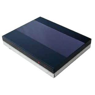

Beomaster 7000 was a receiver of high specifications and contained the system infra-red transceiver for communication with Beolink 7000 and the necessary computer to process and relay the commands to the other sources. Beomaster 7000 was the audio master and as such defined the system. Besides being a computer with considerable processing power, Beomaster 7000 […]
Beomaster 7000 was a receiver of high specifications and contained the system infra-red transceiver for communication with Beolink 7000 and the necessary computer to process and relay the commands to the other sources. Beomaster 7000 was the audio master and as such defined the system. Besides being a computer with considerable processing power, Beomaster 7000 also contained an FM/AM radio, the switch circuitry and the control- and power-amplifier.
