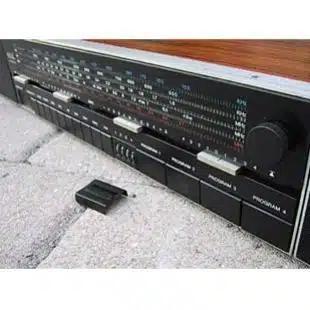

Another of the high quality receivers which succeeded the Beomaster 900. Often referred to as the Tandberg designs, these certainly struck out in a different direction than Jensenโ€™s designs and were much more in keeping with the TV range of the time.
Type Number:2113, 2114, 2115
Release Date:1970, 1971, 1972, 1973
Wave bands:
FM 87.5 โ€“ 104 MHz plus 4 fixed-tuned stations
LW 147 โ€“ 350 kHz, 2040 โ€“ 857 m
MW 520 โ€“ 1600 kHz, 578 โ€“ 188 m
SW1 1500 โ€“ 4500 kHz, 200 โ€“ 66.6 m
SW2 5.9 โ€“ 18 MHz, 49 โ€“ 16 m, with expander
Power output: 15 W RMS per channel (20 W music power)
Frequency Response: 30 โ€“ 25,000 Hz +/- 1 dB
Distortion: less than 1 % between 40 and 12,500 Hz
Signal-to-noise ratio: better than 50 dB
Tone controls: Bass control range: +10 dB -16 dB at 40 Hz
Treble control range: +13 dB -16 dB at 10,000 Hz
Channel separation: better than 40 dB at 1000 Hz; better than 30 dB at 10,000 Hz
RIAA amplifier: built-in
Voltage: 110 โ€“ 130 โ€“ 220 โ€“ 240 V
Power consumption: 15 โ€“ 120 W
Outputs:
2 pairs of speaker outputs โ€“ 4 ohms
Tape recorder outputs: 82 k ohms โ€“ 100 mV / 1000 Hz
Dimensions H x W x D: 12 x 42 x 23cm
Weight: 5.5 kg
Connections:
Gramophone, 4 mV โ€“ 1000 Hz / 470 k ohms
Tape recorder, 200 mV โ€“ 1000 H< / 470 k ohms
Speaker input, 4 ohms
AM aerialโ€™ FM aerial 75 ohms
