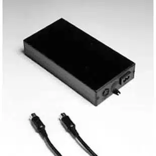

This kit is designed to allow a Beovision to be used in a link room but have full access to the sources, both audio and video, in the main room. It attached to the link TV by means of a 7 pin cable and had no IR receiver as it utilised that in the TV. […]
It attached to the link TV by means of a 7 pin cable and had no IR receiver as it utilised that in the TV. A separate RF cable was required between the RF modulator on the main room set and the link TV.
