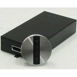

BeoLink Active
Link room product BeoLink Active kit with sound control circuitry, stand-by switching and IR-receiver
This comprises a control box, an IR receiver and a mains lead.
This allowed the connection of active BeoLab speakers which would then have independent control of volume and tone settings. Both audio and video sources could be selected and there was also the option of using the Beolink receiver to enable the Timer, alter the volume and enable play or initiate Stand By.
