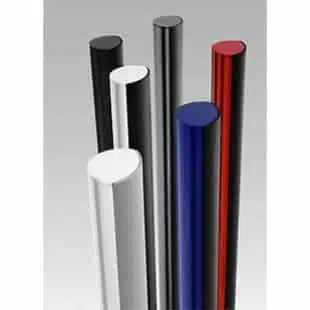

An update to the cheapest of the column speakers, this saw the Class AB amplification discarded along with the large heat sinks. Instead 2 cool running ICE amplifiers were fitted, both rated at 125W. The LED was repositioned and the finish of the foot changed to match the TV range. A three position switch for […]
The LED was repositioned and the finish of the foot changed to match the TV range. A three position switch for wall, corner and free position settings was now fitted and the previous model’s phono plug was deleted. 2 Powerlink sockets were still present though.
Release Date:2010
Designer:David Lewis
