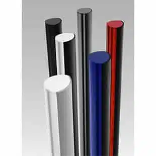

As easy on the eye as they are on the ear, BeoLab 6000 loudspeakers – designed by David Lewis – defy conventional thinking in delivering the maximum sound from the minimum of space. There’s not much point in thinking about BeoLab 6000 in terms of watts, woofers or tweeters. There has never been loudspeakers that look like […]
There’s not much point in thinking about BeoLab 6000 in terms of watts, woofers or tweeters. There has never been loudspeakers that look like this – or so clear and rich a sound produced from such slender cabinets. BeoLab 6000 represents both the engineering skills as well as the design capabilities from Bang & Olufsen.
