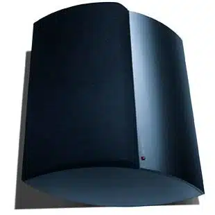

Squeeze a pair of BeoLab 4000s into the bookcase in your study and link them to the music system in the living room, via a Beolink® ‘eye’, which responds to your remote control. Whether it’s a matter of placement or simple colour co-ordination, BeoLab 4000 turns flexibility into an art form. Placing amplifiers directly in the loudspeakers themselves not only improves sound quality but allows the manufacturer to reduce the cabinet’s overall size. The result is a compact loudspeaker that can sit on a shelf, bookcase or hang, at almost any angle, from the wall or ceiling. Available in six vivid colours, BeoLab 4000 is equally at home in a stereo setup, a surround sound system or as superior multimedia speakers for your computer.

You can use BeoLab 4000 as your main loudspeakers or as extras in a Bang & Olufsen surround-sound set-up. Their ability to fit into the smallest of spaces, or to be hung on the wall at almost any angle, also makes them the perfect loudspeaker for the Beolink® system. BeoLab 4000 owes its shape to the fact that active loudspeakers produce heat if they have to play for a long time without a pause. Squeeze it into a bookcase and it will still have sufficient cooling air around it, no matter how many books it shares its space with. Raised on the optional stand, BeoLab 4000 presents itself at the same angle as BeoSound Ouverture.

2007 saw the introduction of the Beolab 4000 Mk2 . Almost unheralded, the main change was the use of ICE amplifiers to replace the AB type. At first glance it would appear that the amplifiers from the Beolab 4 were being used. These offered a power output of 35W each with 2 being used. This was remarkably similar to the real output of the older amplifiers and not surprisingly the maximum sound levels achievable were not changed. Indeed it was unlikely that any customers would have noticed the change if not told.
