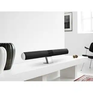

BeoLab 3500 was the first-ever dedicated Beolink® speaker ever released from Bang & Olufsen.
At first it was designated LCS 9000 (Local Control System 9000 from 1992 to 1993) and was manufactured for the old Beolink® system, Master Control Link. But since one of Bang & Olufsen’s great advantages is compatibility it was of course already prepared for the new Master Link system.
Being a Beolink® speaker it houses all the electronics within it required to work as a part in a Beolink® system. No additional boxes are needed – only a cable between the hi-fi and the speaker. Even an infra-red transceiver is built in. BeoLab 3500 also has a display and a digital clock built in.
BeoLab 3500 is an active loudspeaker with two speakers for stereo sound and an integrated Beolink® receiver-unit complements the unit. It has been specially designed for the distribution of sound to rooms in which one moves around a lot, such as the kitchen. For the bedroom, a workshop, basement or even a children’s room, a BeoLab 3500 could be the right solution with full remote control via Beo4. A dedicated Beolink® loudspeaker, it fits into its standard bracket on the wall, on top of a book case, or over the door in the dining room. Its red LED display keeps you informed about which source you are playing.
With two bass and treble loudspeakers, each with its own amplifier, the sound level can be adjusted independently of the other loudspeakers in the system. Hang BeoLab 3500 on the wall on its standard wall bracket or use the optional polished aluminium stand to display it on a shelf or table.

Dimensions: 111×9.5x11cm
Weight: 10 kg
Cabinet finish Polished aluminium
Max. sound pressure 97 dB stereo
Power amplifier modules 4
Long-term max. output, power/module 71 W
Effective frequency range 56 – 20 000 Hz
Cabinet principal: Bass Reflex
New drivers have also been introduced on the model as from June 2006: woofer 9 cm and tweeter 1.9 cm.
