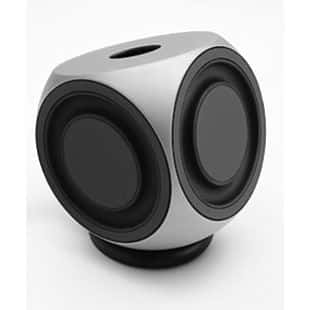

BeoLab 2 Subwoofer: Put yourself at the eye of the storm and enjoy a new sound experience. Just when you thought it couldn’t get any better – it does. The BeoLab 2 subwoofer has only one purpose: to exploit the new world of sound that Digital technology has opened up. Sit back, hold on tight […]
BeoLab 2 Subwoofer: Put yourself at the eye of the storm and enjoy a new sound experience. Just when you thought it couldn’t get any better – it does. The BeoLab 2 subwoofer has only one purpose: to exploit the new world of sound that Digital technology has opened up. Sit back, hold on tight – and experience a deep bass sensation you only thought possible at the cinema or concert hall. BeoLab 2 is the latest (2001) member of the loudspeaker family and has been specially designed to handle the low end of the sound spectrum. It completes your surround set-up and allows you to experience details in movies and music that you’ve never heard before. It just about as good as bass gets!
it’s the smallest things that make all the difference!
The new powerful BeoLab 2 adds a totally new dimension to the Bang & Olufsen sound experience. As digital technology opens up a whole new world of sound, the compact BeoLab 2 subwoofer lets you experience a deep bass sensation that you only thought possible at the cinema or concert hall. Reproducing the low frequency sounds that normal loudspeakers can’t reproduce, BeoLab 2 utilises its built-in 850 watt amplifier to ensure that you no longer only hear your favourite piece of film or music, but feel it as well.
Adaptive Bass Linearisation
Adaptive Bass Linearisation (ABL) is a process patented by B&O and is incorporated in BeoLab loudspeakers. The idea is to use the surplus capacity in amplifiers and driver units, arising by normal listening levels, for a bass extension – a sound reproduction with more bass, than the loudspeaker otherwise would be able to produce.
The function is adaptive. This means that the loudspeaker adapts to the signal it receives. Loudspeaker drivers are therefore fully exploited, without suffering mechanical or electronic abuse, and the built in amplifiers are not subjected to signals would otherwise create an overload situation.
ABL gives stunning bass reproduction considering the size of the loudspeaker in which it is incorporated, under normal listening levels.

The first design model of BeoLab 2, was finished in high gloss black . Its width was 230mm and the loudspeaker membranes were shielded behind a round grille. The model expressed the wishes of designer David Lewis to reflect proper balance between both the demands for excellent sound reproduction and good looks.
In designing the new sub-woofer, the next step was to make a drawing of the exterior as a starting point, in relation to its internal components. In allowing these components to be fitted, BeoLab 2’s specifications had to be enlarged. This new width became 4cm larger. However, it was widely agreed that this was marginally too large so a compromise of 260mm was agreed upon by the design group at Struer. And this is the width of the BeoLab 2 today!
