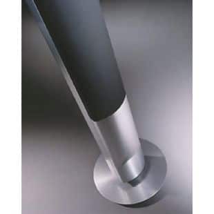

Appearance
Using aluminium for the cabinets is not just about looking good. Despite a thickness of only a few millimetres, it’s a remarkably strong metal that’s easily shaped to eliminate the problems normally experienced with loudspeakers made by traditional materials
Colours
Once the surface has been polished until it shines like a mirror, it’s dyed and given a tough ceramic coating that seals and protects the coloured exterior. The 5 strong colours match with the existing Bang & Olufsen range, and have been carefully chosen to compliment any environment in which they’re placed. Choose between silver, blue, black, red or green (1999 – 2003 range).
