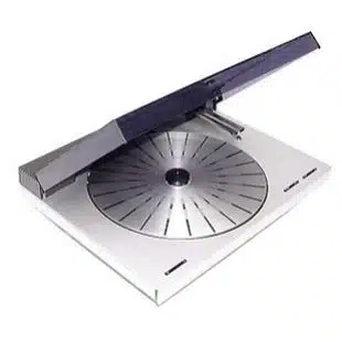

This good-looking tangential record player had a unique tone arm suspension system among its many outstanding features. Optimum Pivot Point (OPP) was designed by Bang & Olufsen to give you the most faithful possible sound reproduction. The pendulum suspension isolated all vibration at the back of the tone arm so that the sensitive stylus tip […]
This good-looking tangential record player had a unique tone arm suspension system among its many outstanding features. Optimum Pivot Point (OPP) was designed by Bang & Olufsen to give you the most faithful possible sound reproduction. The pendulum suspension isolated all vibration at the back of the tone arm so that the sensitive stylus tip was completely unaffected. It also had electronic Servo-drive and was fitted with the MMC 4 cartridge. The stylus pressure was 1,2g.
Facilities: search function – backwards and forwards; repeat playing of records; Datalink for connection to Beosystems.
This was the first of the lightweight tangential decks which were to become the mainstay of the Beogram range. The expensive tangential drive system of the 8000 was dropped and even the tangential arm mechanism was considerably simplified. They did however look the part and allowed far more control using a remote than the earlier radial 5000. Many owners of Beomaster 5000s ‘upgraded’ their systems with this deck but would miss the overhead light built into the lid of the 5000 and, dare one say it, possibly lose some sound quality.
Pickup: MMC 4
Tracking force: 12 mN / 1.2 g
Wow and flutter: DIN 80 dB
Speeds: 33 – 45 rpm
Speed deviation: < +/- 0.2 %
Patented Pendulum suspension
Anti-static platter
Repeat and search functions
Automatic registration of record size and speed
Power supply:
5921: 220V
5923: 120V
5924: 100V
5925: 240V
Power consumption < 10 W
Weight 5.3 kg
Link compatibility: Data Link
