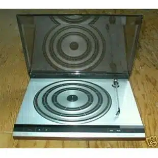

Beogram 3404 was designed specifically for the US market and was produced between 1980 and 1982. It incorporated an MMC 20E diamond stylus.
Type Number:5747
Release Date:1980, 1981, 1982
Designer:Jacob Jensen
Cartridge Type:MMC20E
Speeds / control range 33 – 45 rpm /> +/- 3%
Wow and flutter, DIN 65 dB
Rumble unweighted > 45 dB
Motor / drive system Servo controlled DC / belt
Tonearm Radial, low mass
Bearings Knife vertical, ball horizontal
Tracking force 0 – 20 mN / 2 g
Antiskating Integrated in tonearm system
Cartridge: MMC 20 E
Recommended tracking force 12 mN / 1.2 g
Power supply / cons: 120 V /8 W
Dimensions WxHxD / Weight: 44.5 x 8.9 x 22.5cm / 6.5 kg
