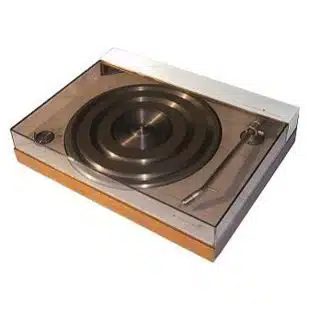

Beogram 3000 was an automatic high-fidelity stereo record-player with specifications which easily complemented those of Beomaster 3000-2.
It was fitted with an SP 12A pick-up cartridge which had an elliptical naked diamond stylus, with a stylus pressure of 1,2g. Frequency range was 20 – 25000 Hz ±3 dB and distortion was lower than 1%. Wow and flutter was less than ±0.09% and rumble was better than 62dB. Beogram 3000 was easy to operate: you simply selected the size of record you intend to play – 7″, 10″ or 12″ – and press a button. The record-player automatically selected the record speed, 33 or 45 rpm, and lowered the pick-up into the first groove.
When the record ended, the pick-up arm lifted up, returned to its resting position and the turntable switched off. The turntable and pickup arm had a pendulum suspension which made the record-player insensitive to vibrations. The deep furrows in the turntable made it easy to pick up records. A hinged dust lid was fitted; it could be set at any angle up to around 60 degrees or completely removed by a simple sliding action.
