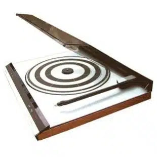

BeoGram 2400
Beogram 2200/2400 were identical except that, when coupled to the Beomaster 2400, Beogram 2400 could also be operated by remote control.
To play records on either model it was necessary to simply press START and let the automatic system do the rest. As an additional safeguard, all functions could be operated with the protective lid closed. The electronic servo drive system kept turntable speed constant and correct, even during fluctuations in the mains supply. Careful arm geometry ensured that tracking angle was kept well below the level where it could affect the quality of the reproduced sound.
Bias effect was compensated automatically and needed no adjustment. The extreme lightness of the arm, together with the highly polished nude elliptical diamond carried by the MMC 20EN pickup in the 2400, resulted in an unusually low Effective Tip Mass (ETM). This means that your records would suffer very little wear, even after continual playing. Neither would they be damaged if the stylus was accidentally skidded across the surface.
Beogram 2400 could be made up as part of the Beosystem 2400 when linked together with other compatible Bang & Olufsen products.
