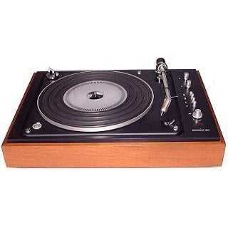

Beogram 1500 is the acclaimed Beogram 1000 3-speed stereo record player equipped with a built-in stereo output amplifier delivering 2 x 8 watts of audio output. The Beogram 1500 has no built-in loudspeakers but may be se with external speakers e.g. the Beovox 800 or the Beovox 1000. The Beogram 1500 has jacks for radio […]
The Beogram 1500 has jacks for radio and for tape-recorder – the Beocord 1500 de Luxe would be particularly suitable. If you use the Beogram 1500 in connection with an FM tuner e.g. the Beomaster 5000, you have a small but complete hi-fi system.
The Beogram 1500 has separate adjustment knobs for volume (with built-in balance adjustment), bass and treble. Pushbutton panel for control of on/off, tape recorder, radio, and gramophone. All these functions are conventionally placed on the top of the instrument. Built-in voltage selector for switching between 110, 130, 220 and 240 volts AC. The Beogram 1500 is very elegantly designed and has a transparent dust cover
In the real world, this is a Beogram 1000 with a rather nice 8W per channel amplifier attached. There are two types with the later ones using the same amplifier as the very upmarket Beocord 2400 reel to reel deck. Surprisingly good though the isolation of the deck was no better.
